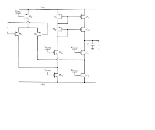

An alternative structure that may meet your needs is a folded cascode opamp (ota) like:
That topology will be compensated by the load capacitor, yet still have high open loop gain. It is the "really really slow" option mentioned by Carl. It will act like a low pass filter with a pole at gm/(2*pi*Cload), where gm is the transconductance of the diff pair. The down side is that the output resistance of this circuit will be 1/gm so you have to make sure that the Iav/gm drop from the average current is less than the tolerance you require.

Gain error due to finite opamp gain is related to "systematic" error. Instead of gain = 1, it will be A/(1+A). I think 60dB is fine.
Like Carl was saying earlier, you can do this two different ways. 1) a fast buffer that recovers before the end of the period, or 2) a slow buffer with a big filter capacitor that prevents the reference voltage from changing. With an external capacitor you are doing 2). You will never get an amplifier to be fast while loading it with a few uF.
That folded cascode amplifier will work fine in either approach assuming your SAR is switched capacitor so the amplifier doesn't have to drive a resistive load.
